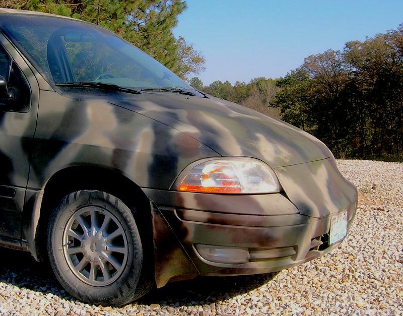

I have made my front grill cover permanent now. It is finally gotten smooth enough to start looking good too (Apply a thin layer of micro, sand it off, repeat.). Today I fitted it in so that that the hood could be opened without removing it. I have a 1/8" gap so that is pretty small. I may use a technique that learned to make the gap as thin as a layer of duct tape.

Thanks: 178
Originally Posted by Varn View Post
The image isn't showing up.
I downloaded it, it's a blank image

fixed link.
Here is the stock front. From straight on it hard to get a visualization of the lower lip created by the bumper.
