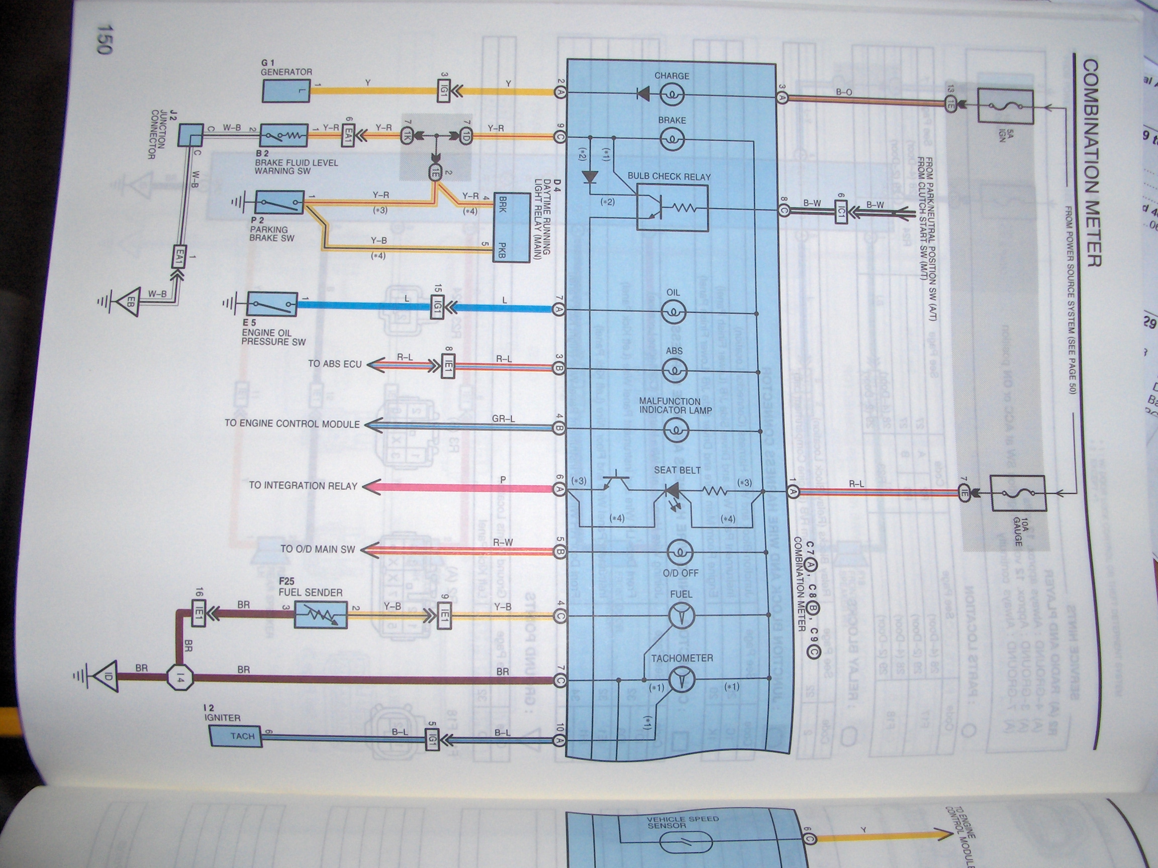

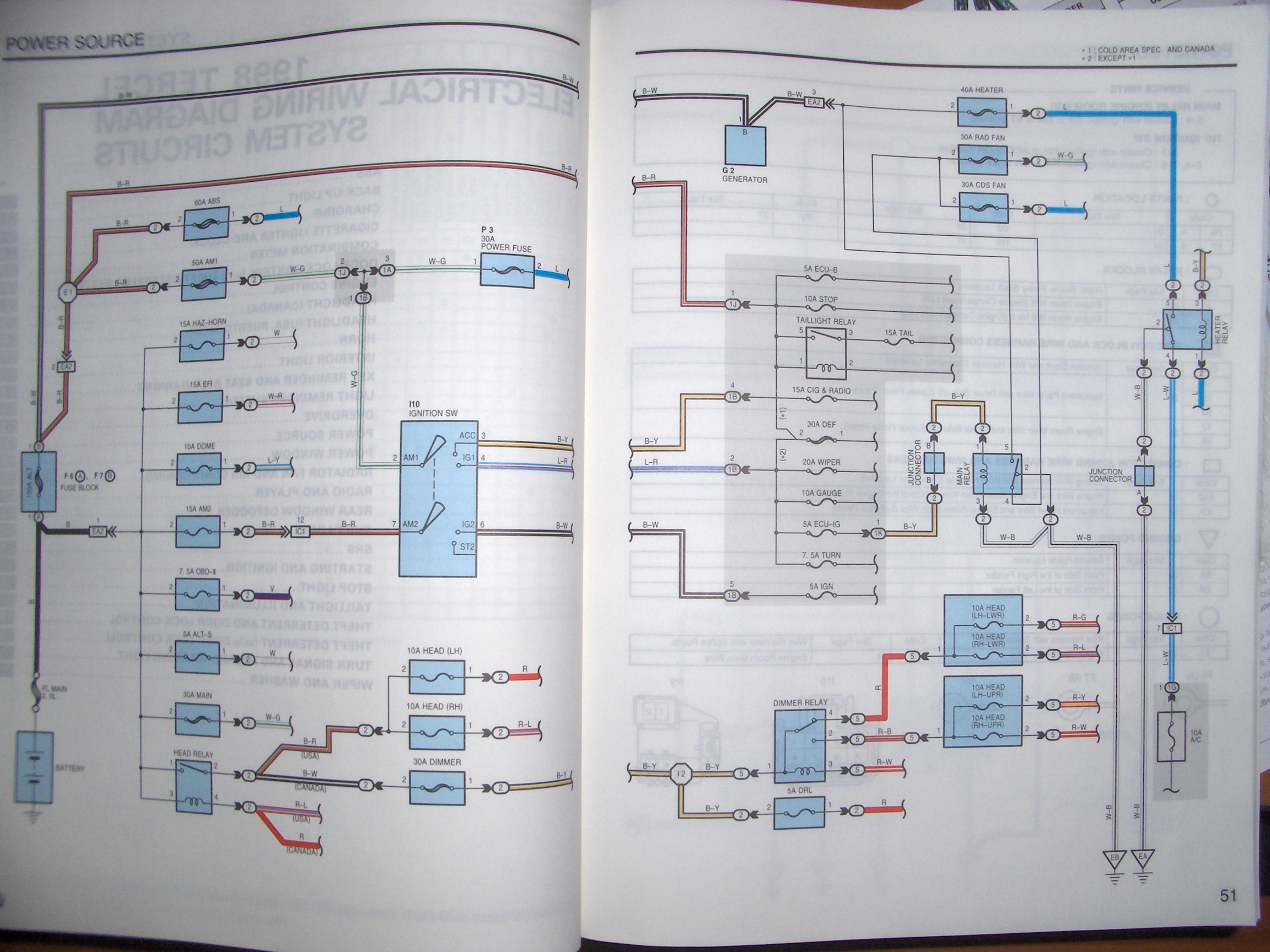

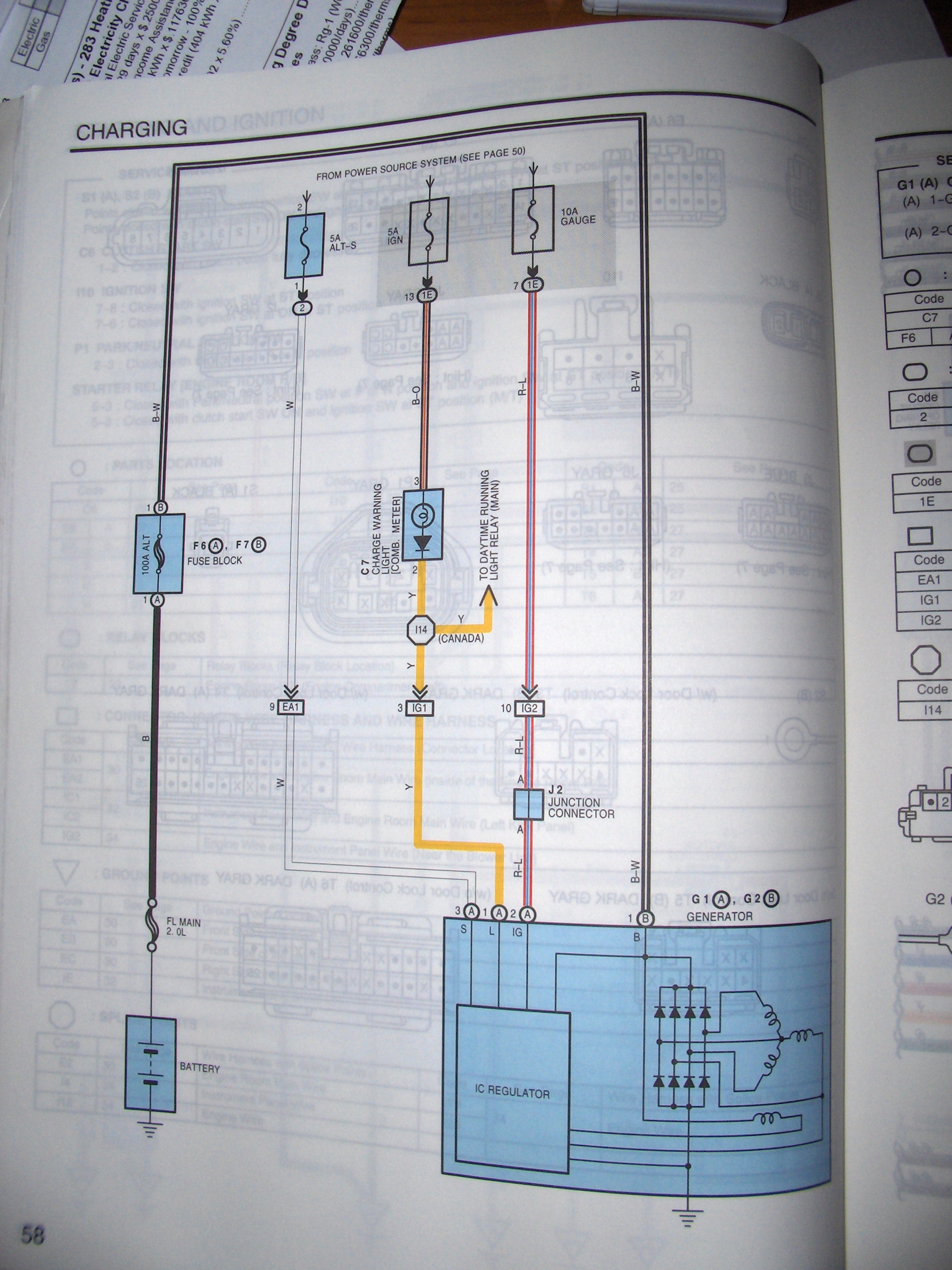

Alright, I'm looking into how I want to go about disconnecting the alternator in the Paseo. So, I opened up my service manual and took a look at the wires going to the alternator. There is the main wire going to the battery and three more on a separate connector.
The pictures are huge, so I linked to them.
alternator diagram
So, in an effort to figure out what one of the three wires controls the field strength, I started pulling fuses. As it ends up, the '10A gauge' fuse is the one that disables the field. Unfortunately, it also disables my gauges cluster.
Here are the other diagrams for the whole system and gauge cluster where the 10A gauge comes in.
system diagram
cluster diagram
Any ideas on how to get around this? I'd rather not disconnect the high amperage line to the battery if possible.
Just disassemble the 3 wires on the separate connector.
Chances are they separate out on their own on one end or the other (either at the alternator or voltage regulator).
If they are all in one connector on both ends, you can usually get the crimp ends out of the plastic connector with a tiny screwdriver. The crimp ends are held in place by having a little bit of the metal bend and catch the plastic. If you slip a tiny screw driver in, you can pull the wires out w/o breaking them.
Once they are separate, disconnect one at a time and see what happens. Which ever one makes the battery voltage (or ammeter) fall, you found your field circuit.
Put the other two back in the connector and reattach them.
The other one can either be left off altogether; what I did is cut that wire in the middle, splice in a much longer wire, and put it on a switch on the dash so I can engage the alt from the cab if I have to.
