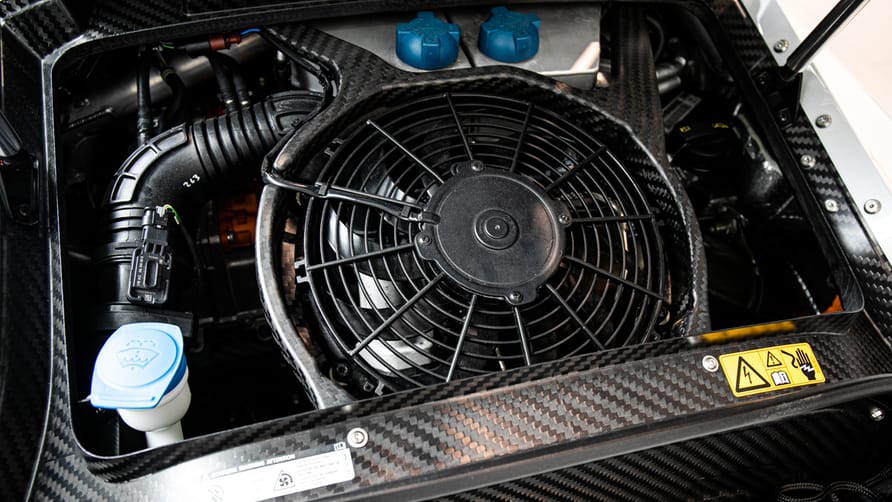

Now that you mention it, I'm less sure about the XL1. It's hard to find good info on it, but I believed it had a heat exchanger up front, for battery cooling, which pulled air in from the middle and vented it on the sides. However I am now unable to find anything to substantiate that. You might be right.
That looks like the fan is blowing downward through the radiator thats above the vents in the bottom.
That would mean; air in the front and out the vents in the 'floor'.
It's difficult to see/tell, but it does look like those vents aren't just slots.
Like some 'direct backwards' and small spoiler type lips aero work is in their design.
