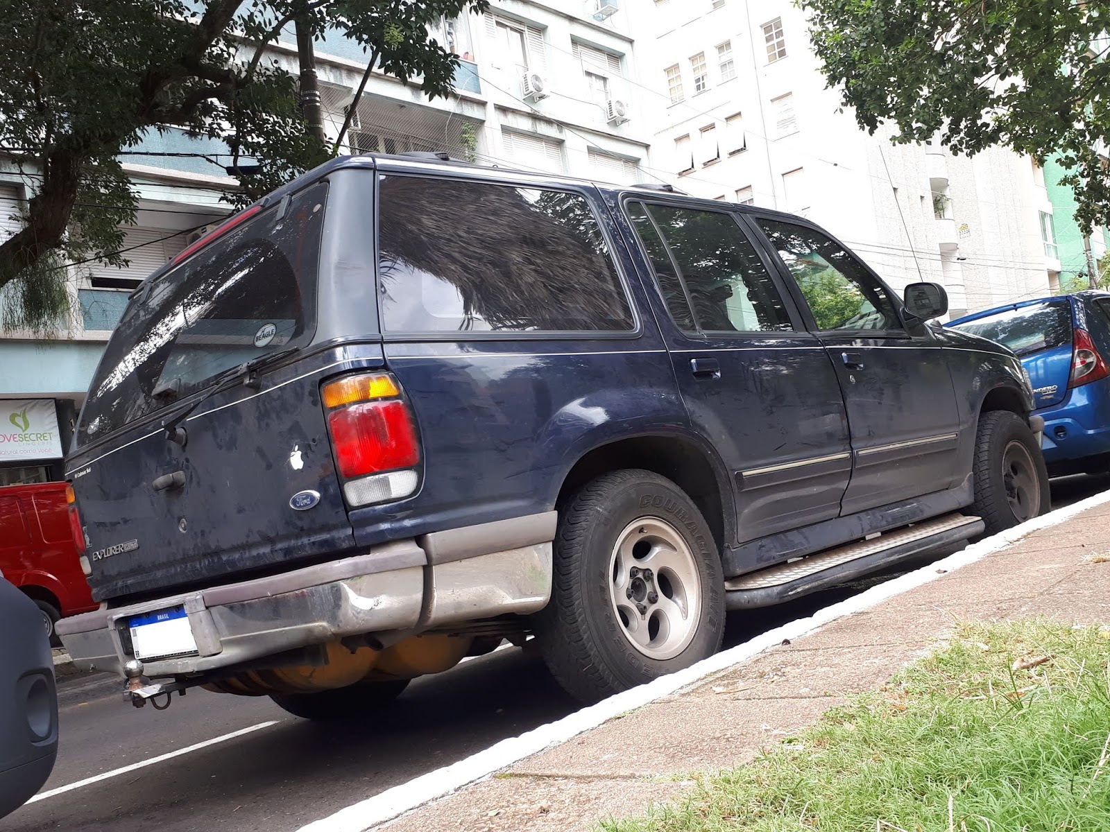

CNG might not be so cheaper than gasoline as it used to be, but it's still what prevents some old American imports from heading to the scrapyard in Brazil... Notice the underbody CNG tanks on this Explorer.
