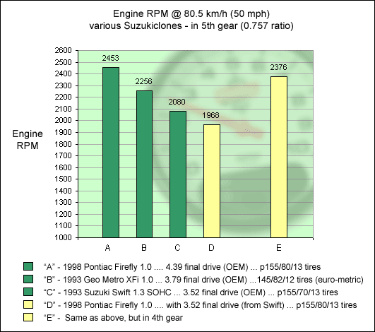

Originally Posted by zonker View Post
who knows, with the 3.08's and a taller tire, i might have 3rd gear match what 4th gear was before, and have a REALLY tall 4th for flat road economy.
That's close to what I ultimately did:
Tallest final drive available for my car's transaxle made my "new" 4th gear just slightly shorter than my "old" 5th gear.
I started with "A" below, finished with "D" and "E".
I'd still go with a taller 5th gear if I could.
