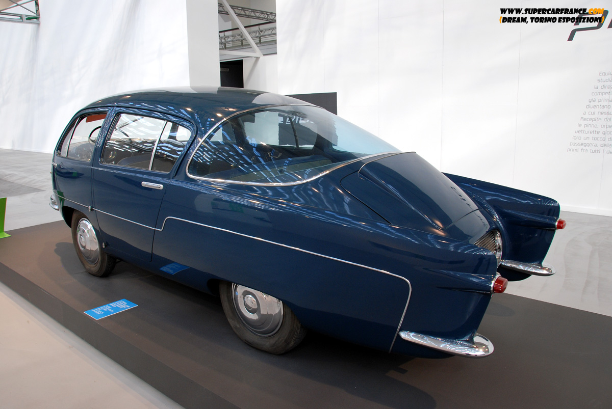

Wow - another car I have never seen before!
M-1000 (1954-1956)
Engineer Alberto Morelli started in 1953 a study for an aerodynamic car, on a mass-produced chassis, the Fiat 1100\103. The car, completed in 1956 and called M1000 was realized on a new chassis, with a rear engine. This car reached 133,140 km\h without changes in its Fiat engine. This prototype was too ahead for its time, but Pininfarina noticed Morelli's work and asked him to develop another prototype, the PF-X , with its odd wheel-disposition, showed in 1960.

Every time I see a cool low drag car like the M-1000, the first thought I have is to see if an electric drivetrain would be likely to be used to lower the drag even more. Because they require far less (or almost no) air flow, and they don't have hot exhaust systems. Cooling a hot internal combustion engine with a minimal drag cooling system means that the operating temperatures will be dancing on the edge of reliability.
Also, seeing the chassis for the M-1000 shows the design solution for the use of the interior volume that is pushed forward - the front wheels have to fit under the front doors (which are hinged at the back) and the front suspension is directly under the front seats.
Very often, low drag cars push the engine to the back - where it fits and people do not - and this means that the heaviest part of the car is at just about the worst place in a low drag car; because of the issues of side winds. The rear fenders on the M-1000 may just solve some of this, though?

...But your feet are the first thing to hit the wall, or the bumper of the SUV in front of you...

There could be a better safety structure within the front of this car - it would be rounded, so that would deflect the car (as opposed to engaging) from what you were hitting. Your feet are always the first part of you to be involved in the crash - what matters is how the structure is engineered.
The aerodynamics of this M-1000 are about as close to ideal as I've seen; short of the Pillbug or the Dolphin. It ain't perfect, but it shows that Alberto Morelli has chops... but we already knew that, right?

That's such a gorgeous car. I want a model of it. Being a responsible adult sucks.
