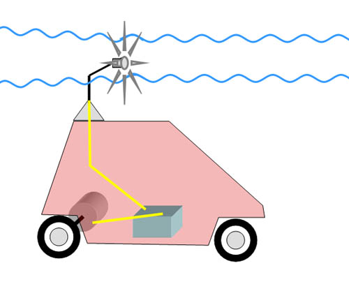

It was found that the rotating paddle wheel can generate 16.1 watts while reducing drag by 7.7%.
Interesting. People have been dreaming about this forever......
from: CHM107 Energy: Quiz
(I kid.)
