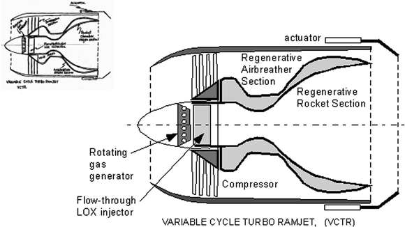

Doing a search on the turboramjet topic I found a combination that I have never seen before.
Commercial Near-Earth Launcher: Propulsion Choices
https://link.springer.com/chapter/10...-662-54744-1_4
The point of this discussion I believe is to explore the introduction or reintroduction of airflow and or pressure differentials at the nozzle exhaust of a ducted fan/propeller/jet thrust system.
