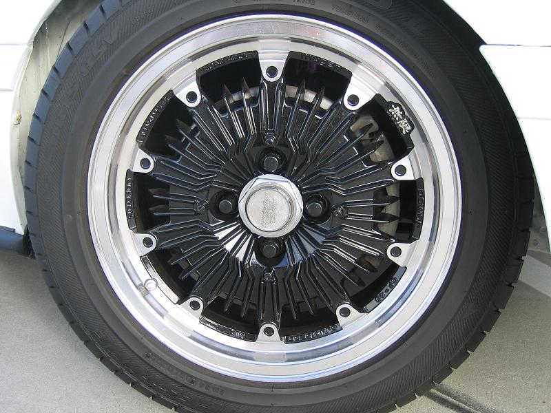

It's been covered except for rim diameter/aspect ratio. The comparisons I did suggest aluminum weight approximates rubber, both lighter than steel. So a low aspect ratio tire on a steel rim will have [marginally] more rotational inertia.
Just go for Mugens:
https://deebee8ahh.wordpress.com/2010/03/16/sweet-old-mugen-wheels/
Aero with good brake cooling.

It had to be about the cooling; I looked at that and thought, Dang, that looks like a fan clutch has been made into a wheel.

Centrifugal force rules.
The caps didn't survive well, You can see fastener to the southeast has failed.
I don't how they help cooling. They must put thermal paste under the lug nuts.
