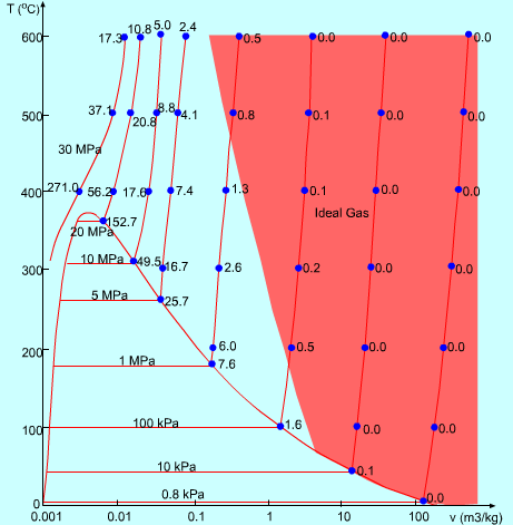

1. You're quibbling about the ideal gas law. While it is true that no gas perfectly behaves as an ideal gas, the ideal gas law is sufficient for most gases. Not saturated steam, and not for steam in various regions of temperature and pressure.
2. You're flat-out wrong about using "since no gas exactly follows the ideal gas law, we can still treat steam as an ideal gas."
Here:
The red area shows where you can treat steam as an ideal gas. Note that for most of the saturation line between steam and liquid, there is no red.

You never ever, ever use ideal gas law for steam.
Use steam tables, they have been established for over 150 years and have been revisited, occasionally revised over the years and expanded.
Unless you are working out side established tables then there is not much choice.
I think I have a different point of view about the ideal gas law , than it seems to me that you do ...the ideal gas law is not the sum total of all influences ... it describes how ideal gasses would react ... the ideal gas law does not include all other factors of real world substances ... it does not include for example that at some temperature and pressure gasoline will auto-ignite , and that reaction will have significant effects on temperatures and pressures ... it also won't tell you what the flame speed of the reaction will be , or what the specific heats of the materials will be, or if they are exothermic or endothermic , etc... it isn't that the ideal gas law doesn't work for systems that have gasoline in the them ... it is not a universal theory of everything ... if the specific substances you have behave in certain ways some of that is not part of what the ideal gas law describes.
I'm sure if someone made a plot of gasoline and air at different temperatures and pressures ... like that graph of yours for water and steam at different temperatures and pressures ... that there would also be significant parts of the graph that also deviate greatly from what just the ideal gas law would predict without any other considerations of the substances.
Which is what I see that graph of yours showing ... to me , it is showing that if you only looked at the ideal gas law and ignored the other behaviors of the substances involved , you would at some temperatures and pressures get very different results than what just the ideal gas law alone would predict... and to me ... that is completely expected to me ... and in no way invalidates the principles of the ideal gas law itself ... it is not a theory of everything ... and I don't expect it to be.
