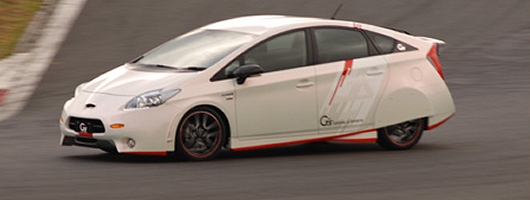

Still, SimuTech, which performed CFD analysis on the lowering springs and body kit (and 17" wheels!) with the PLUS package, claimed an improvement in drag. Looking at some of the streamlining images, as well as those of other cars, it appears to me that one overlooked benefit of lowering is decreased turbulence from the wheel wells.
