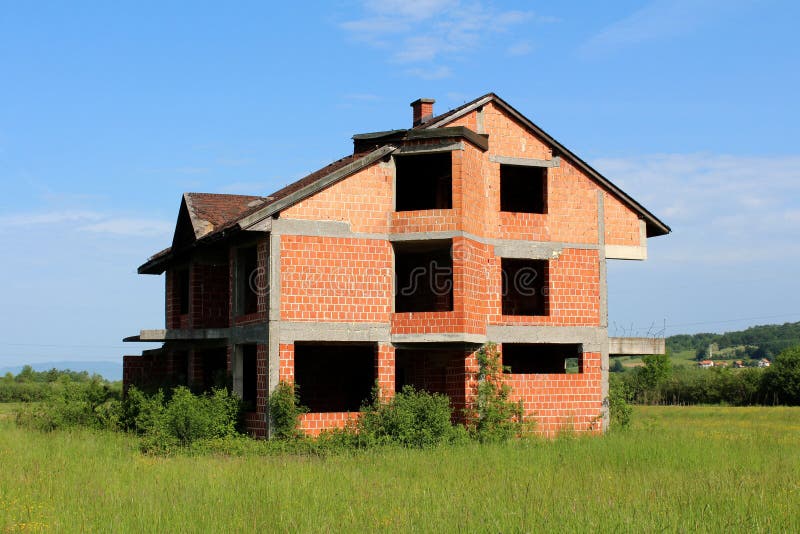

What do you recommend we use instead of wood framing? The vast majority of houses I see in Latin America are concrete and brick (With no insulation). They are also to be painted and need to be repainted periodically.
Before the finish skim coat and paint:
