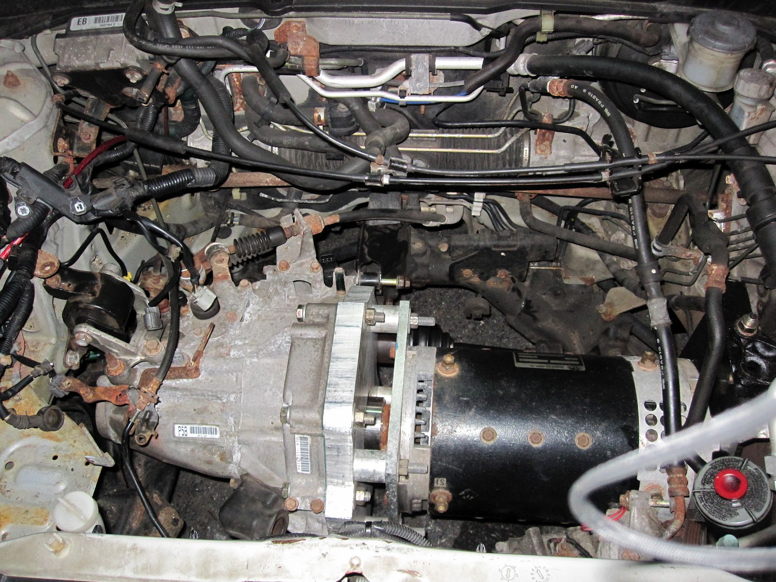

The motor and transmission is installed! Today we got all the mounts installed and now we are working on removing the gas tank. I was late getting out of work so I wasn't able to pickup the transmission fluid, so tomorrow I'll get it I hope.
I'm still on my imaginary goal to be working on the control trays this weekend, once this gas tank is out its controller wiring time!

Looking good.
I hope you don't mind, but pictures really make all the difference, so I reposted your latest:
