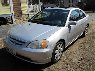

Last week I started the build on my new EV, a 2001 Civic EX. My old 1996 Civic EV did me well for 4 years of fun and learning, but the body was starting the need work and the lead acid batteries had worn out. I decided it was time for a rebuild with more fun and range in it.
So here are my goals for this EV:
- 80 to 100 Miles Range
- 65+ MPH
- 8 second 0-60
- Use the J1772 charging stations
I am using my FB1-4001a with the coupling and plates from the older Civic, my Zilla Z1K-LV, 45 cells of CALB 180 AH, Elcon 2KW charger and a much nicer Civic with a perfect body.
Right now I have the engine and muffler stripped out, the electric motor mounted to the manual transmission with a stage 4 clutch and all the parts sitting in my bedroom waiting to be installed.

(Added a pic from your blog of the new car to your post)

Today I had planned on getting the motor installed this morning, but I had to run off to do some shopping for vacation and pickup a new front motor mount. I also had misplaced a bolt and once I got everything nearly installed we found the axle had a much higher diameter than the 1996 Civic did! So out everything went and then I had to remove the entire coupling system to cut wider holes at the axle area.
Well it was a good 8 hours this afternoon and we finally got the motor installed! Well mostly, I have two mounts to bolt down, but the rain came and I had to return the hoist to my neighbor so I'll finish the bolting next Sunday when I return.
