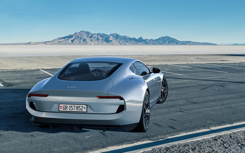

https://duckduckgo.com/?q=piech+automotive+EV
Thiel Invests As EV Startup Piëch Automotive Hires Porsche ...
https://www.forbes.com/sites/michael...d-tesla-execs/
Founded by Anton (Toni) Piëch, the son of European automotive legend Dr Ferdinand Piech and the grandson of Ferdinand Porsche, Piëch Automotive aims to produce customer EVs by 2022. Photo: John ...
EV Startup Piëch Automotive Appoints Former VW Group Boss ...
https://www.carscoops.com/2020/10/ev...r-as-chairman/
Piëch Automotive's team also includes former BMW, Porsche, and Tesla executives. ... Figuring out which electric vehicle startup will survive or not is a lottery these days, ... Piech.
As a Tesla and VW fan I find this interesting. Ex-VW and Tesla executives' new startup has a design almost as good as the Renovo/Cobra Coupe. And a five-minute 80% charge rate.
https://www.insidehook.com/wp-conten...1551816354.jpg
https://i.pinimg.com/736x/c6/08/72/c...97e0e43983.jpg
Face the danger and row away from it.
David B. Frohnmayer
_________________
aerohead (10-07-2020), AeroMcAeroFace (10-06-2020), JulianEdgar (10-06-2020)

I like the look of the front of that car, it is the first new car that looks happy. I do wonder though if the 80% in 5 minutes is from 0% or 20%, and where that would be practical to do without specialised grid connections. Rough calculations: 0.2kWh/km and 500km range gives 100kWh. They must be charging at about 1MW to get a 5 minute charge. That is like a small power station's worth of power.
