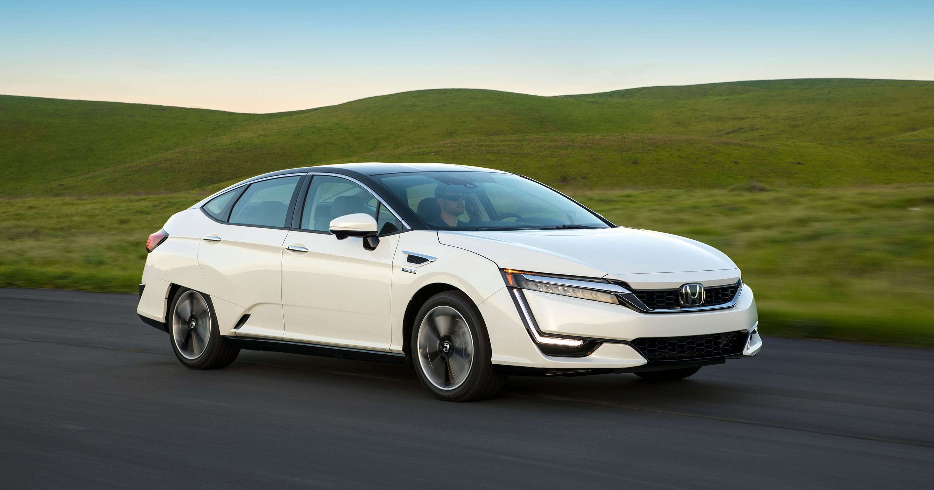

An early concept of the Clarity?
aerohead (06-05-2019), Ecky (06-05-2019)
Looks far better than what they ended up with...
Yes - they got quite timid, when it came to production.

Considering it seems aimed at the same crowd as the Toyota Avalon, I'd say the production styling was probably a safer bet.
