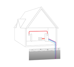

There are a number of different systems like this in Sweden, as I don't really know the names I'll write a short description
Drill a hole about 200m deep into the ground, pump water down to the bottom and warm water comes back up.
Lay a pipe (1 km or so) a meter or so under the ground, and pump water through it.
Lay a pipe (1km or so) along the bottom of a lake and pump water through it.
There is a forth system where a hole is drilled and then instead of water, air is blown down into the hole and the air comming back out is warmed.
