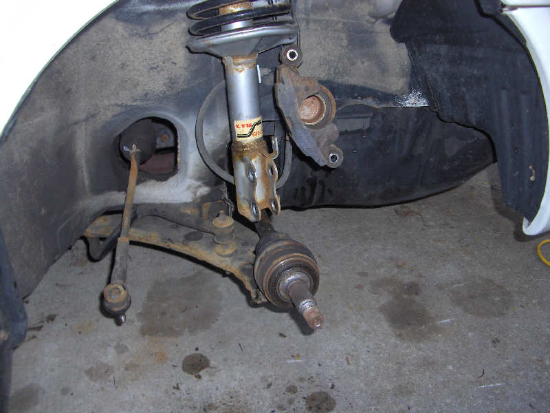

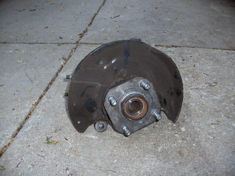

Tonight I pulled the hub off the Paseo to replace the front passenger wheel bearing. Not too much to it and it went easier than I thought. Tomorrow I'll be taking the hub in to get the bearing pressed out and new bearing installed. This time I got pics.
Everything pulled off.
The hub.
