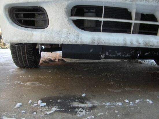

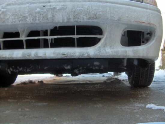

Step one (baby step that is) is underway. This weekend it was actually warm enough to work. I'm really getting cabin fever with all the new stuff I'm reading, and I wanna go get some stuff done. So, at 25°F this Sunday, I went at it.
I got my package of stainless fasteners from mcmaster a few days before. I went with the bulk route due to the price. This order cost me $28 for 100 M6 bolts, washers, and nuts. It would have cost me around $10 to buy just enough for this project alone! So, I have extras for more work down the road.
These are the panels that were removed quite a while ago while doing work on the car. They will be going back on.
Here is the car without the panels on it. There is a lip down there for deflecting air, but I'm sure the paneling helps as the lip does not extend the full width of the car. Yes, I know I'm missing a vent.
This would be the underside of the engine bay without the panel on it. Lots of stuff for air to get caught up on and go around eh?
A few nuts and bolts later we have a nice cover over some of those protruding transmission parts. Still not the smoothest thing around, but a definite improvement.
