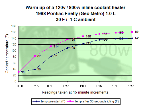

Latest mod:
I moved the 800 watt coolant heater over from the Firefly this weekend.
From thread: https://ecomodder.com/forum/showthre...-warm-817.html
I'm also going to try out a coolant temperature sensor mod, which I've never done before.
