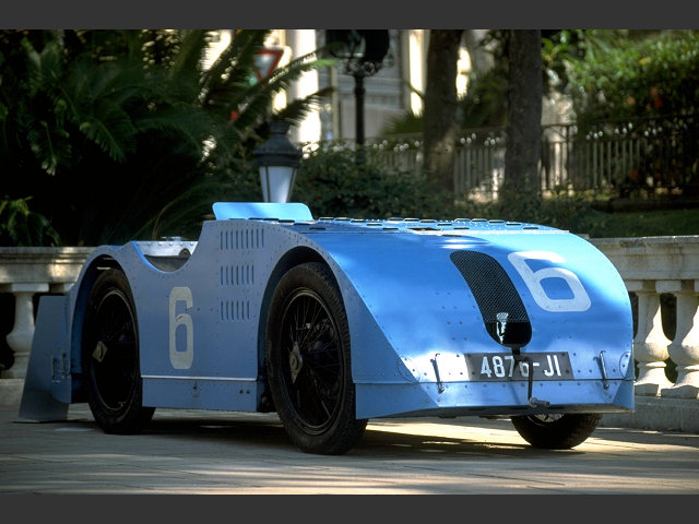

The "Tank" type 32 was built just one year after Jaray applied for his patent on vehicle aerodynamics (which was granted in 1927). The "Tank" was panned at the time by the French press for it's looks. I'm trying to find out if it had a flat belly pan. Apparently it was "interesting" to drive...
“You can well imagine that with no firewall there is intimate communication between driver and machinery. The clutch whirrs dangerously close to one’s left leg, the pipes get hot, oil splatters all over you, and there is a lot of exhaust, hot water, steam, noise and danger. The exhaust glows, gas dribbles steadily on your feet, and backfires light up the universe. All very exciting.”

Found a couple of shots of the interior showing how the driver literally sat in the engine compartment. The co-pilot was saddled with the exhaust pipes, poor bugger.
I believe this is a faithful replica. I'm trying to find out if it had a full belly pan. I can see glimpses of it in this photo:

she's a beauty,but I suspect separation at the headlight bezels,everything behind the windshield would be in separated flow,and too much air would be going underneath.And I bet that's a nasty undercarriage.

I found a shot that shows a bit of the belly pan on the T-32 The salient question on this car is whether the air would reattach behind the cockpit.

I've never run across any quanta for these cars,although GOOGLE never ceases to amaze,so perhaps at some point we may get some hard numbers.
Hucho did make a comment with respect to the 'tank' in his 2nd edition,and wrote that he believed the car would probably suffer separation in the area where the windscreen would typically be and never recover.
I've been spending time with Jaray's development model and I am convinced that even in separated flow,the aft-body still performs a beneficial function.
Without a technical term to draw on,I'm refering to it as 'stuffing the wake.'
And it's a concept aerodynamacists stumbled onto when testing convertibles with the top down.
By placing manikins in the open car they were able to measure lower drag do to this 'stuffing,' and I think that the aft-body of the Bugatti 'tank' is helping to perform this function.
All,except the last of Jaray's models( the full-tail) suffer separated flow very early on the body but do not suffer the drag as would occur at the same point for a Kamm chop,so the tail must serve drag reduction even though it's less than ideal.I believe it's true of all pseudo-fast-back cars.
