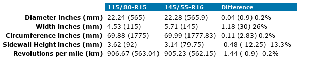

If you punch in the specs, it spit this out for 155/70 r19, and 175/60 r19(REX)
tires:
For comparison this is the 115/80 r15 and 145/55 r16 of the XL1.

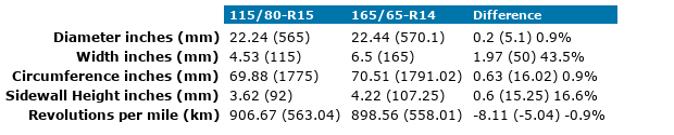

And the Xl1's 115/80 r15 compared to the Insights 165/65 r14:
IT would only be 0.2 inches smaller for a 0.9% difference. 0.6inches less sidewall, and the magic number: 43.5% less width!
