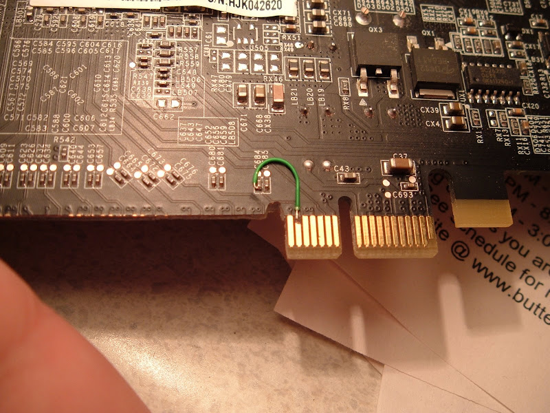

@Paul, don't let surface-mount stop you, there are many many benefits to surface mount.
If you are just worried about soldering to the surface-mount chip then get a Schmart board ( SchmartBoard - The world's best circuit prototyping system ) or a dip adapter and have somebody else do the SMD soldering.
SMD soldering isn't all that hard, you just need a steady hand, keen eye, and a nice sharp ~15watt iron. Here is my PCI-e x1 video card with a repair because I was over-zealous with the dremel.

nice fix add some hot glue for longevity! Why on earth did you attack it with a power tool?
A dozen pages back i gave paul some instructions on SM soldering. Certainly nothing to be scared of except for BGA packages and 100+pin packages. Leaded solder helps... a LOT.

I would have used a scalpel to remove the insulation over the damaged trace and then soldered a strand of wire across it. Keeping the signal lines as close to the same length as possible is very important in high frequency circuits.

Yes I did realize that, but it has been in use for over a year now (notice that photo is from 2007). Also the standard has been raised to "2.0" and received a near double boost in mhz, so for a version 1.1 link this is fine.
I would have done the as you suggest, if not for the fact that I needed the clearance so that it would fit in a PCI-Express x1 slot and the traces on the low-profile card were running through that area (I also managed to cut the +12v lead to the DDR2 power circuitry hidden on an internal power layer, but reconnected it externally).
To sum up, PCI-e buses are teamed serial connections comprised of 1 to 32 "links" (desktop PC's have at maximum 16 links per connector http://www.naplestech.com/shopcart/bus_speeds.asp ). I wanted to hook up multiple displays with cheap readily available cards (and not saturate my PCI bus).
I learned that the PCIe standard auto-negotiates links and determined that I could operate a card on a single link. If I had any motherboards with a x4 connector I would have likely tried that, but x1 is the "standard".

A better solution is to just take a piece of bare wire (AWG22 or so), heat it up with a soldering iron, and use it as a hot knife to open the back of the slot. Then you don't need to modify the card at all.

If you go to my photo album you will see that I did cut out the back of a PCIe x1 as well. It was the first step I took in trying the mod.
I figured it was better to modify a ~$20 video card than a ~$100 SLi motherboard (two x16 slots, and some x1 slots), so I can have 6 or more screens on one PC.
Also this card can be plugged into any motherboard instantly without voiding the motherboards warranty. As I have done several times already.
Honestly I am tired of discussing this, I did it two years ago and was fully aware of what I was doing.
In case you were wondering why, I realized that my single core PC could play back 3 HD streams simultaneously, and multi-core processors were becoming mainstream.
Also if you want to look into it there are several companies that will let you have multiple users and sessions on one machine, and I didn't care for PCI video cards as mentioned (they are 3 times the cost of the same chip on a PCIe bus, and getting more expensive all the time), not to mention the entire PCI bus is shared bandwidth and interrupts.
