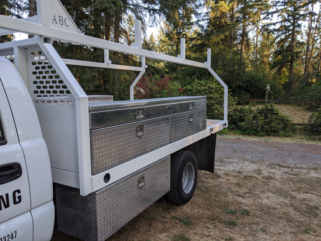

I'm a little behind here. I finished the 1 ton a few weeks ago.

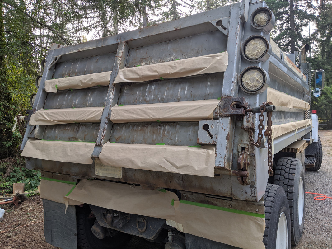

Dump truck:
sanded primed and painted that black box on the right side. It houses a fuel pump for offroad fuel for the excavators.
Painted the wheels.
Prepped and painted the dump box.
Traded in the old excavator for a new JD 35G mini with cab, heat, air, angle blade.
The dump box was my first foray into shooting metallic paint. It schooled me a bit. In the end, I had to devise a scheme to control overspray on the upwards facing surfaces. I masked them off, then painted above the needed 3 coats. Peel off a tier of paper all around and move down, repeat.
