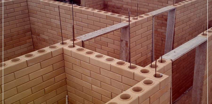

Have you heard about ecologic bricks?
It's made by mix of earth and cement, and put in a compressing machine. It work as legos :

There are manual press and hydraulic press. The manual press take a lot of labor. There are also machines to mix and to sift the soil.
I did a fast research, and found that on Brazil the cost (not including buy the machines) to produce a 1000 ecologic bricks it's about 250 reals (64 dollars), considering soil/earth (need right mix of clay soil and sand soil) cement, water, energy. The sale of the finished brick product it's about 1000 reals.
Ecologic brick are fine for dry climate areas, but not good for high moisture climate. I'm not sure if they are not very good for humid climate because people let the blicks aparent, without a layer of plaster covering it, or if even the plaster can't protec the bricks from moisture.
Making a politic insight, when people say that it's a good idea help homeless have a home, I think the best solution it's to find such alternatives and train homeless people to work building the homes. With ecologic bricks the production cost it's low for who build the bricks (with machine help), and to build the home itself a few training it's enough, with some supervision of course, since some technics place the brick using a special glue. It needs some rebar with concrete, filling the brick's wholes with rebar and concrete, but not all brick's holes but just in some points, each a couple of meters distant or in a edge of wall, I think. But it's quite like a lego building.

Well, Brazil have variable weather along the variable places, since it's the size of a continent. Some are very dry, others are wet or extreme wet (like near Amazon Forest), others are in the middle.
I found the cost, buying the bricks, it's 30% less for ecologic brick house than a standart brick house, but I don't know if it's for a home with finish plaster walls or not. Anyway the amount of plater of cement mass required it's reduced, since the ecplogic bricks have very good shape straight, well alighned and fine in edge gaps.
If you do your own ecologic bricks the cost for the bricks it's reduzed a lot, maybe 1/3 or 1/4 for brick's cost.
Portland cement on USA it's about double the price than on Brazil. Ecologic bricks are not good idea for very humid climates, but wikepedia said they can use varnish to protect the bricks.
" Finishing
Completed walls require either a reinforced bond beam or a ring beam on top or between floors and if the blocks are not stabilized, a plaster finish, usually stucco wire/stucco cement and/or lime plaster. Stabilized blocks can be left exposed with no outer plaster finish. In tropical environments, polycarbonate varnish is often used to provide an additional layer of wet-weather protection."
https://en.wikipedia.org/wiki/Compressed_earth_block
Maybe with two layers of such varnish, it can hold well. But I can't be sure. Maybe require a new layer of varnish after a given number of years. Also I'm not sure if the plaster finish for interior and exterior walls solves the problem of moisture.
