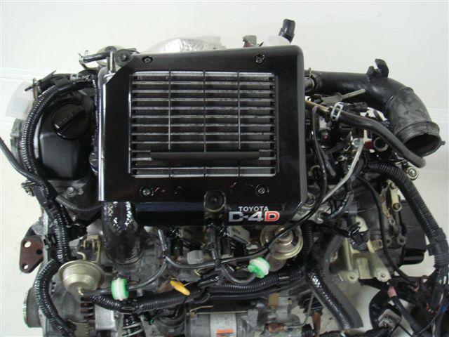

A while back I posted up a ad for a diesel Tercel in Canada that I had found. Ever since, I have been thinking about and now finally looking into what must be done to swap a diesel engine into the a Tercel. It must be a 95 or older Tercel since anything older than 96 is not emissions tested in my area. So, I can't swap this into an echo/yaris which is the intended chassis. Luckily, the Tercel was sold in a 4 door variant that is a requirement for a new car.

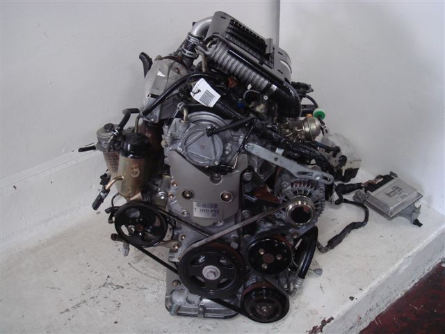

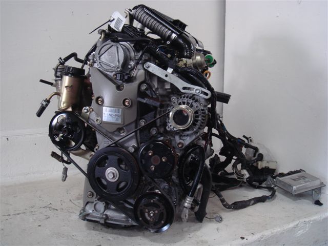

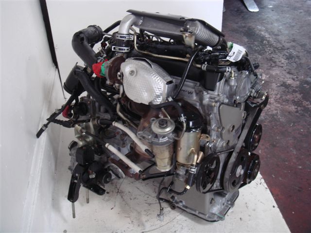

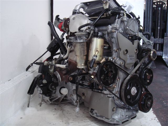

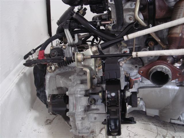

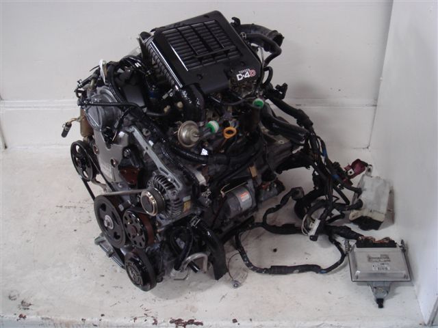

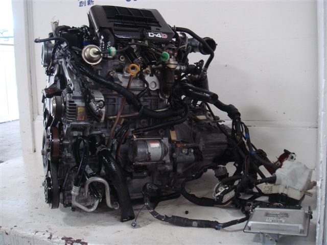

Anyway, I finally got a response from an importer who has an engine (pics below). They actually have the next generation engine which is a 1.4 instead of a 1.5. The engine code is 1ND-TV. This engine won't directly mount up to my engine mounts, but the drive shafts will plug right in.
Now, I know next to nothing about this engine, but it comes with everything you see below. I have a hope that some of our overseas people can help me out with knowing what else I might need to get it running? Or perhaps know where I could download a service manual (in english ) or really just any helpful info to ask the importer.

Well, I poked around google image search and found something missing right off the bat. There should be an EGR cooler (shiny boxy thing in front of the engine) up front from the looks of it. At least thats what I think it is.

Is that supposed to have a turbo?

I am quite sure that is a inter-cooler on top of the engine and the turbo is at the back of the engine. It is a similar set-up to the supercharged Cooper S.
